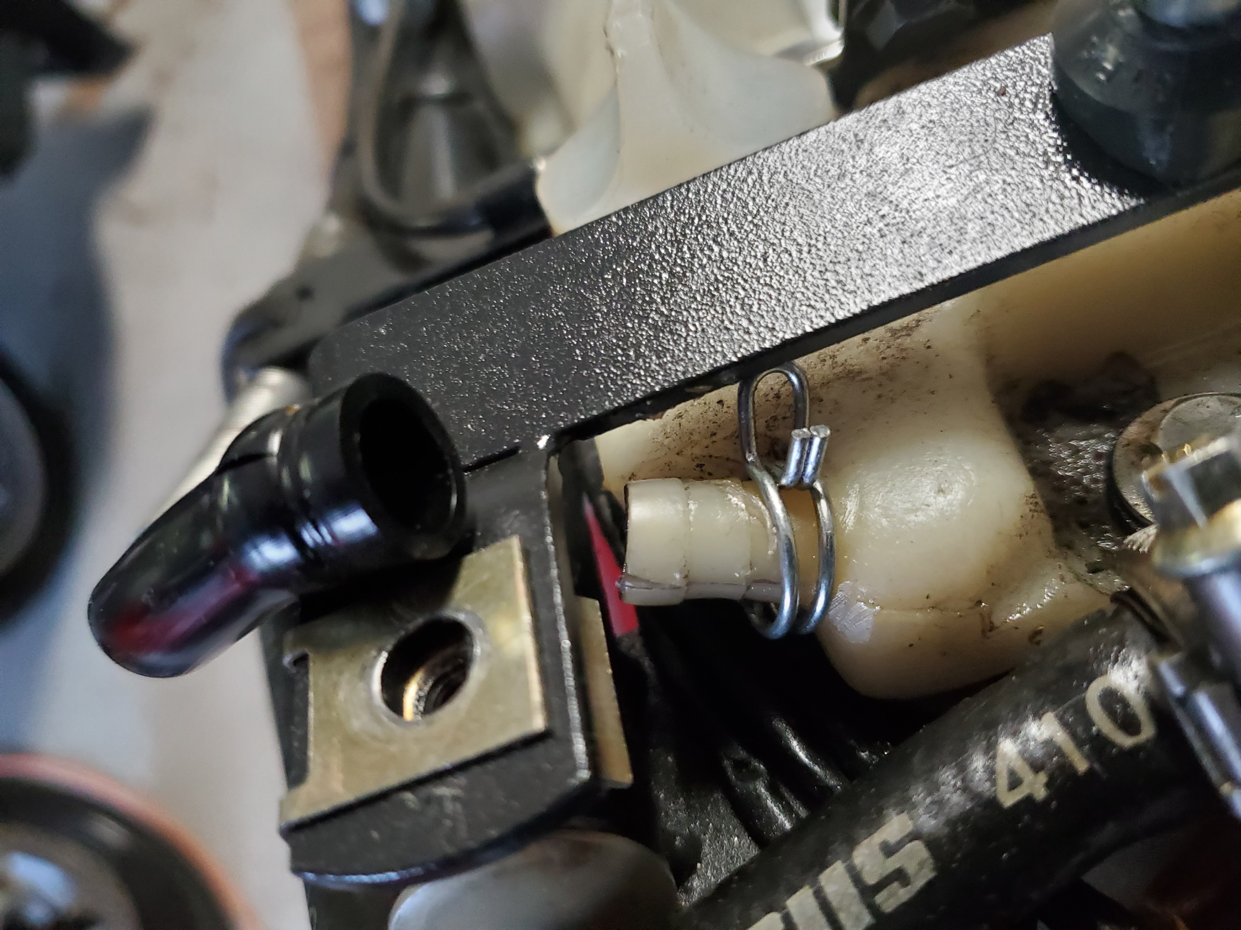

I have a 2006 Skorpion Sport and need to replace the dry sump oil (return?) line on the left hand side of the bike. The rigid line on the bike has cracks in it at the oil tank.

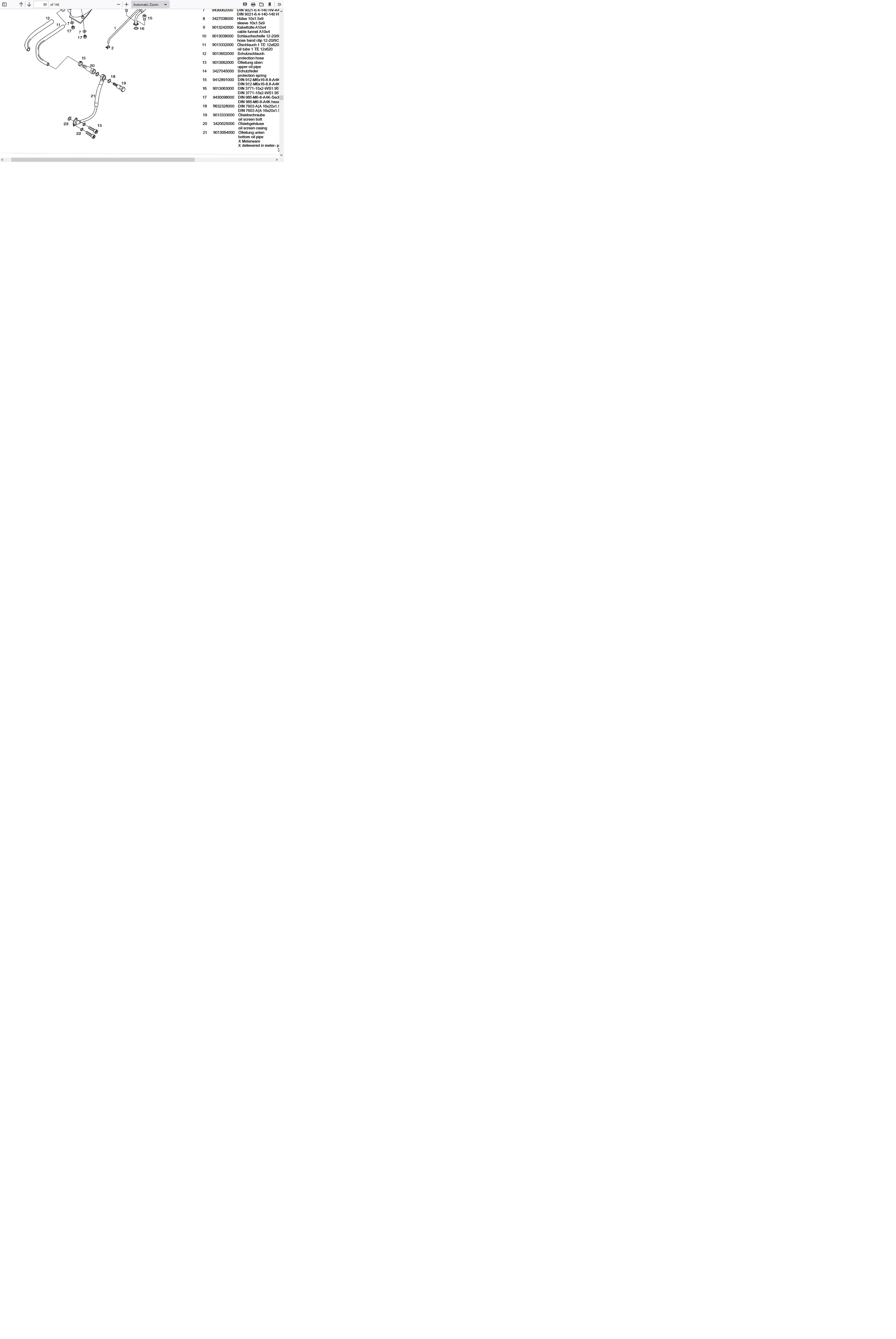

Postby DAVID THOMPSON » Tue Mar 30, 2021 4:34 pm
this may help is number 21 what you need
click on picture to make it bigger its in upper left when shown
number 21 maybe

Postby daiku96 » Fri Apr 02, 2021 7:10 pm
The upper hose through the wire casing
Thank you for the schematic but I can't get it to enlarge to see item #21.
I'll try to post some pics.....

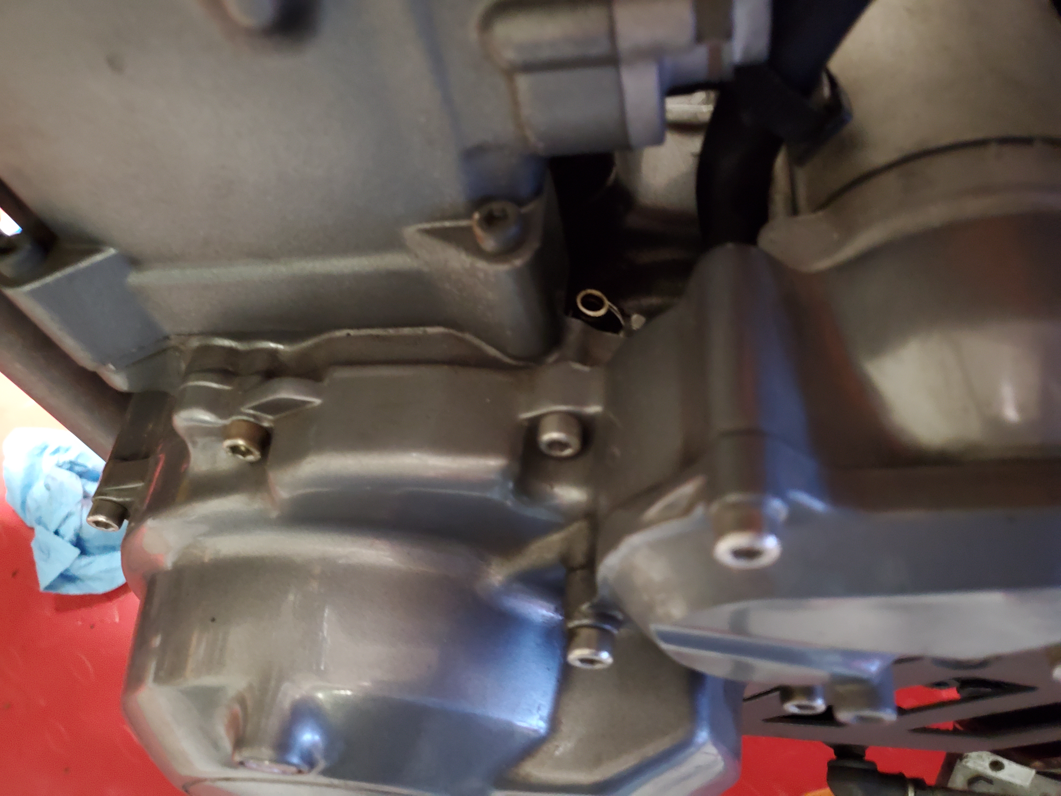

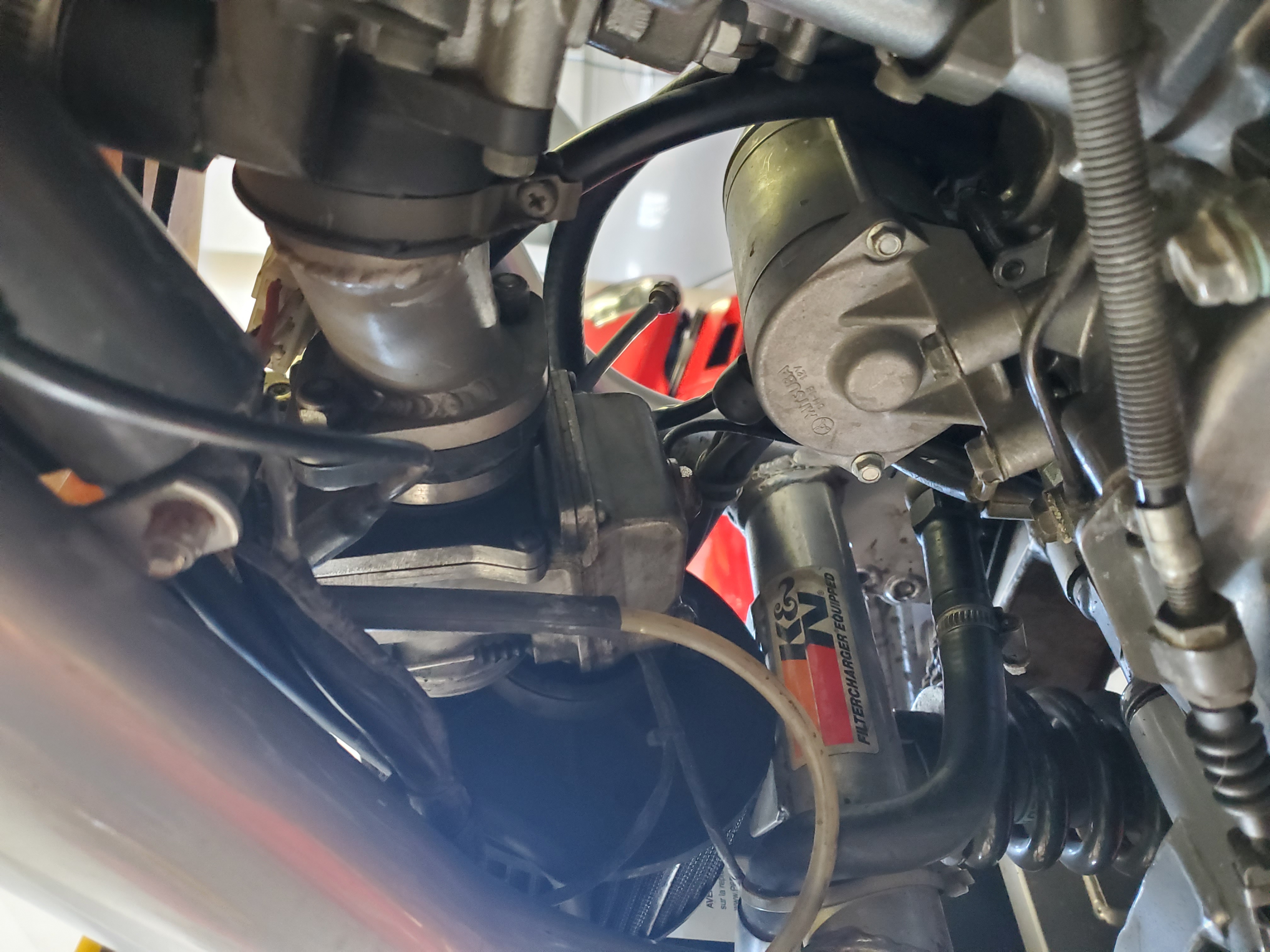

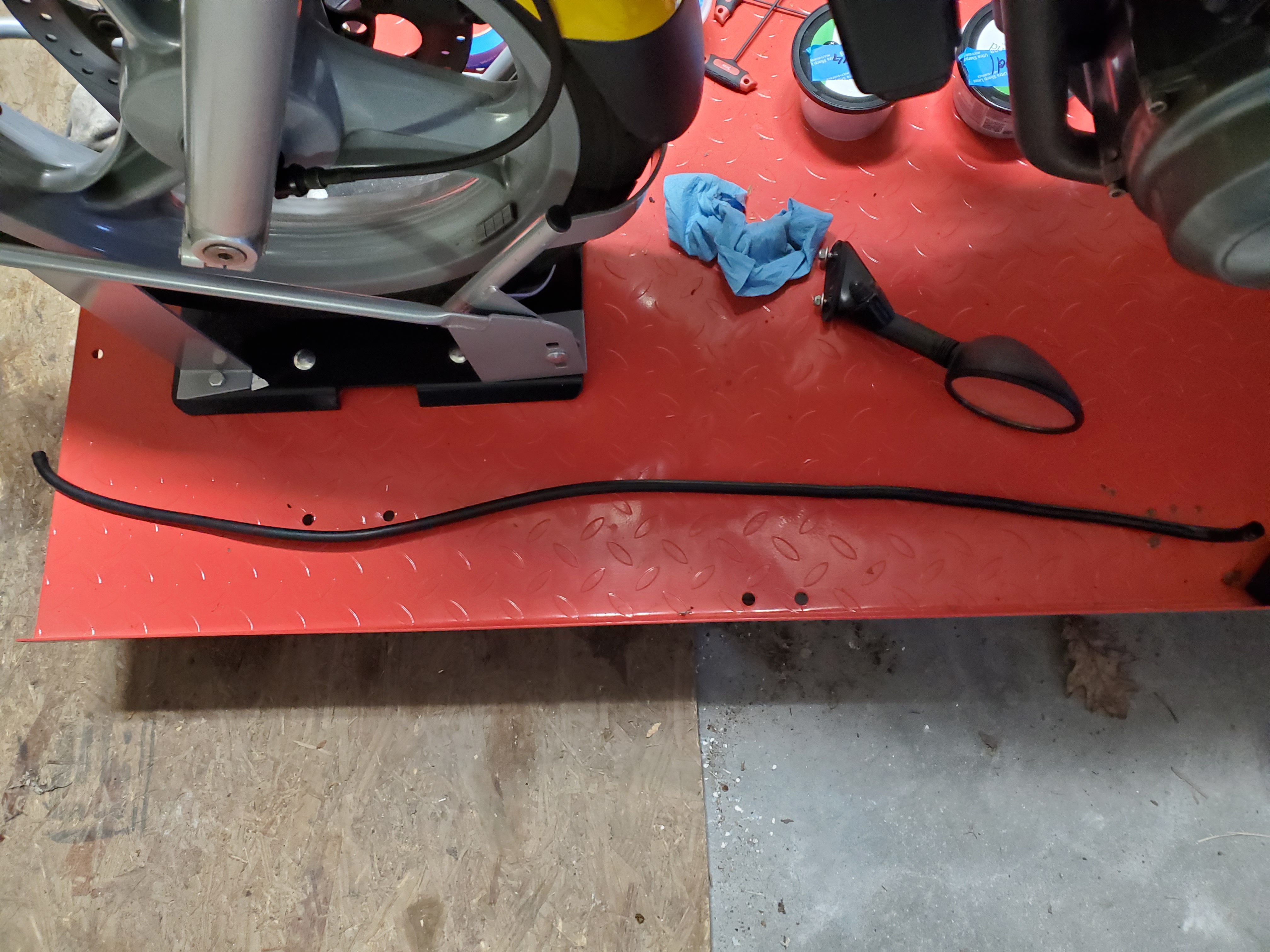

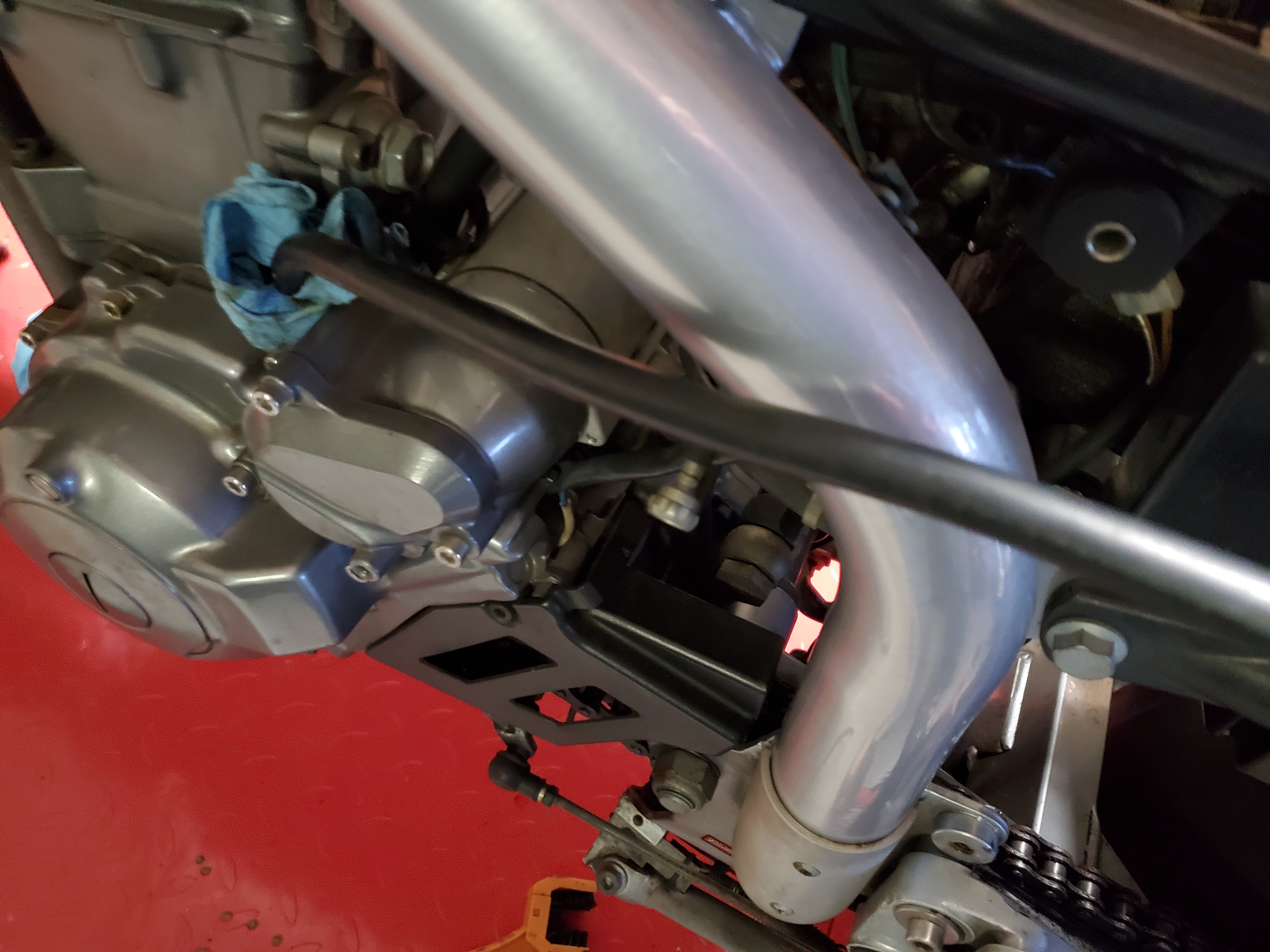

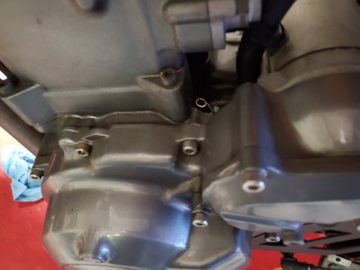

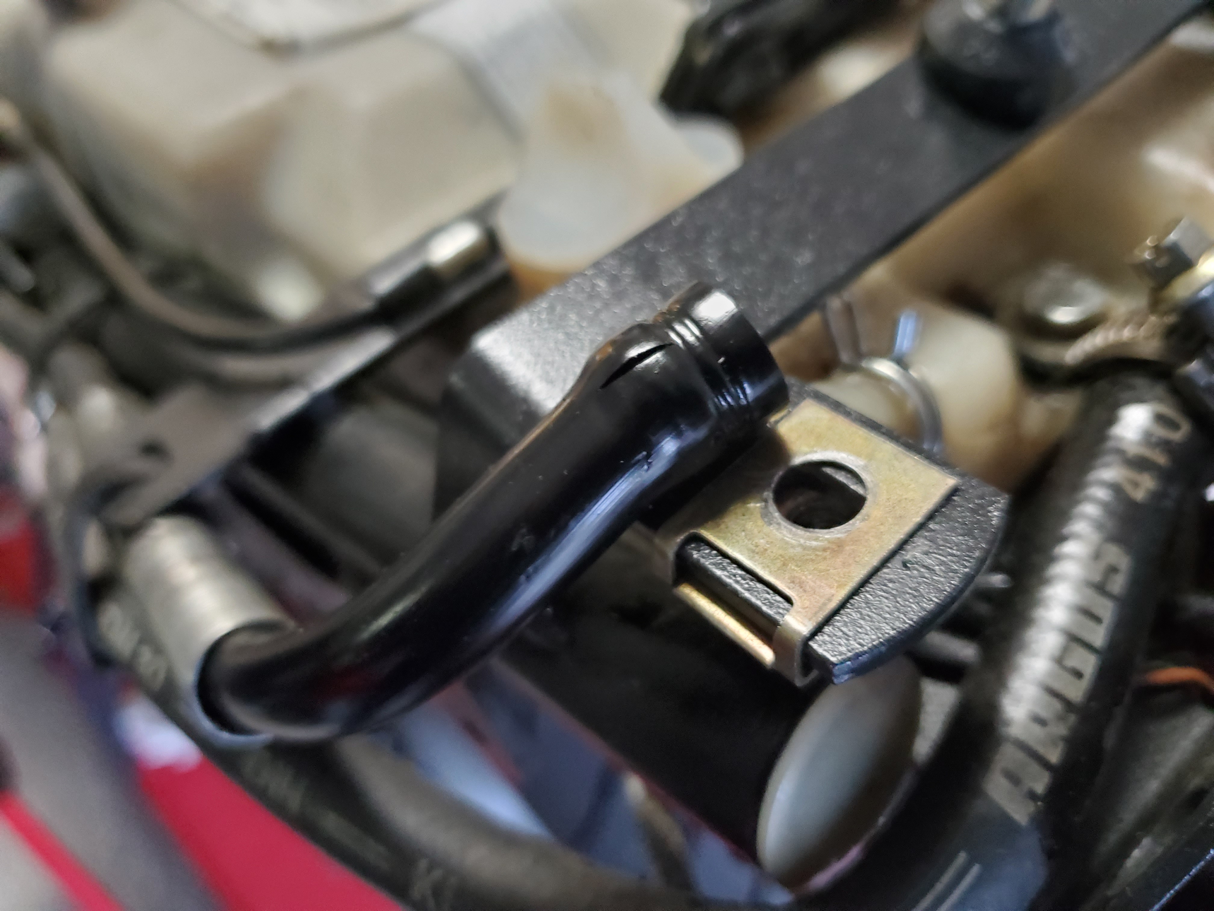

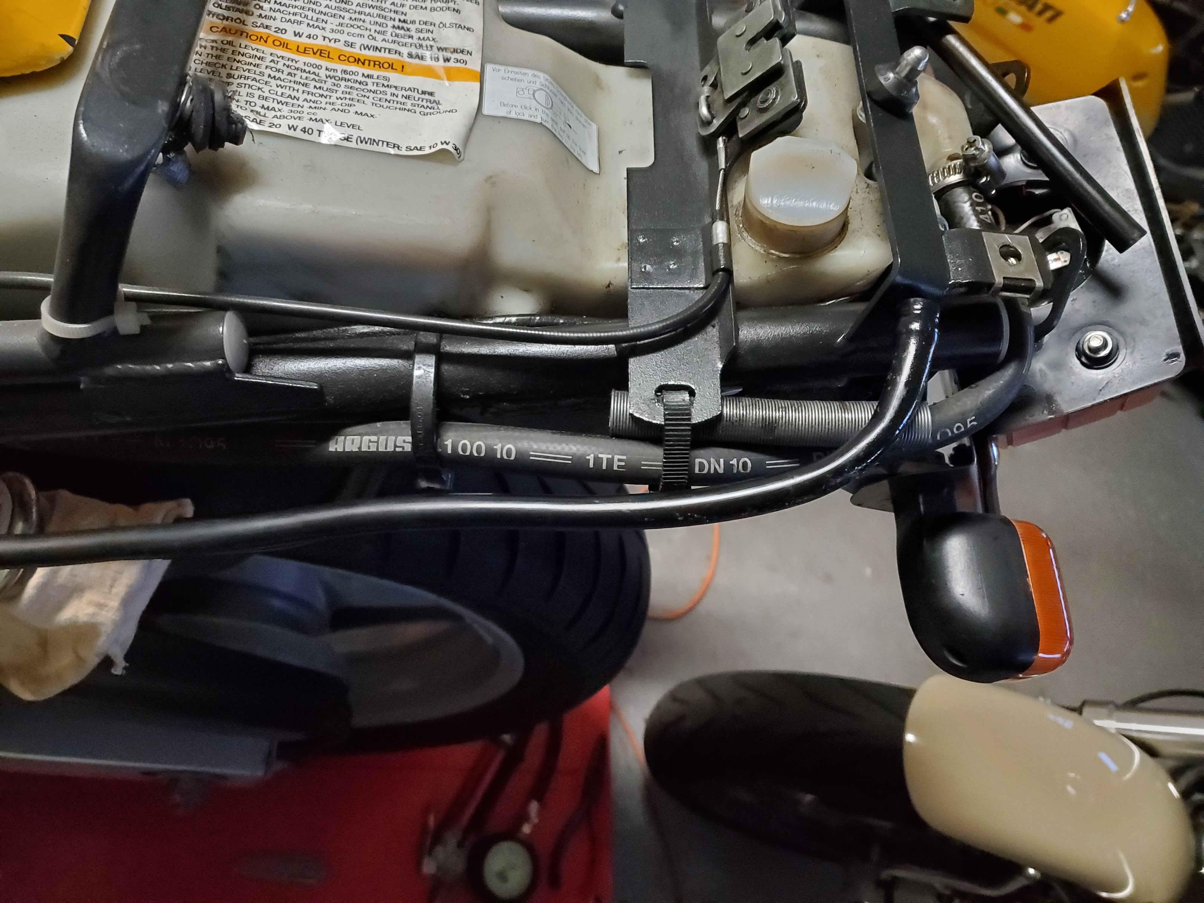

Postby daiku96 » Fri Apr 02, 2021 7:13 pm
Some additional pics of the line in situ and off the bike.

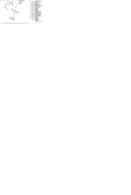

Postby DAVID THOMPSON » Fri Apr 02, 2021 8:10 pm
click on the pic 2 times and use scroll bars to move view to upper left of pic
one of my computers is sick and thats only way to send it
or this link
use control plus to enlarge pic on web site
https://grahamsmotorcycles.com/MZ_Parts ... system.htm
Re: dry sump oil line needed
Postby daiku96 » Fri Apr 02, 2021 9:52 pm
Got it this time, David. Thank you.
It looks like it's #1 on the schematic. I guessed it was an oil return line but it is described as the vent line. The one on the bike is cracked at the oil tank and spewing oil upon start up. It seems to be made of nylon or some other semi-rigid material and it's I.D. is 3/8" but the O.D. is not standard hose sizing... it is quite thin walled.
Postby droy » Sat Apr 03, 2021 7:28 am
daiku96
I've replaced these on several of my Skorpions - you can use standard 3/8 or 5/16 (check the barbed fitting OD on the oil tank to confirm) fuel or oil hose from the local auto part store. Pick up a 5 foot long section. you might need some small hose clamps also - those wire compression clamps are intended for a metric hose.

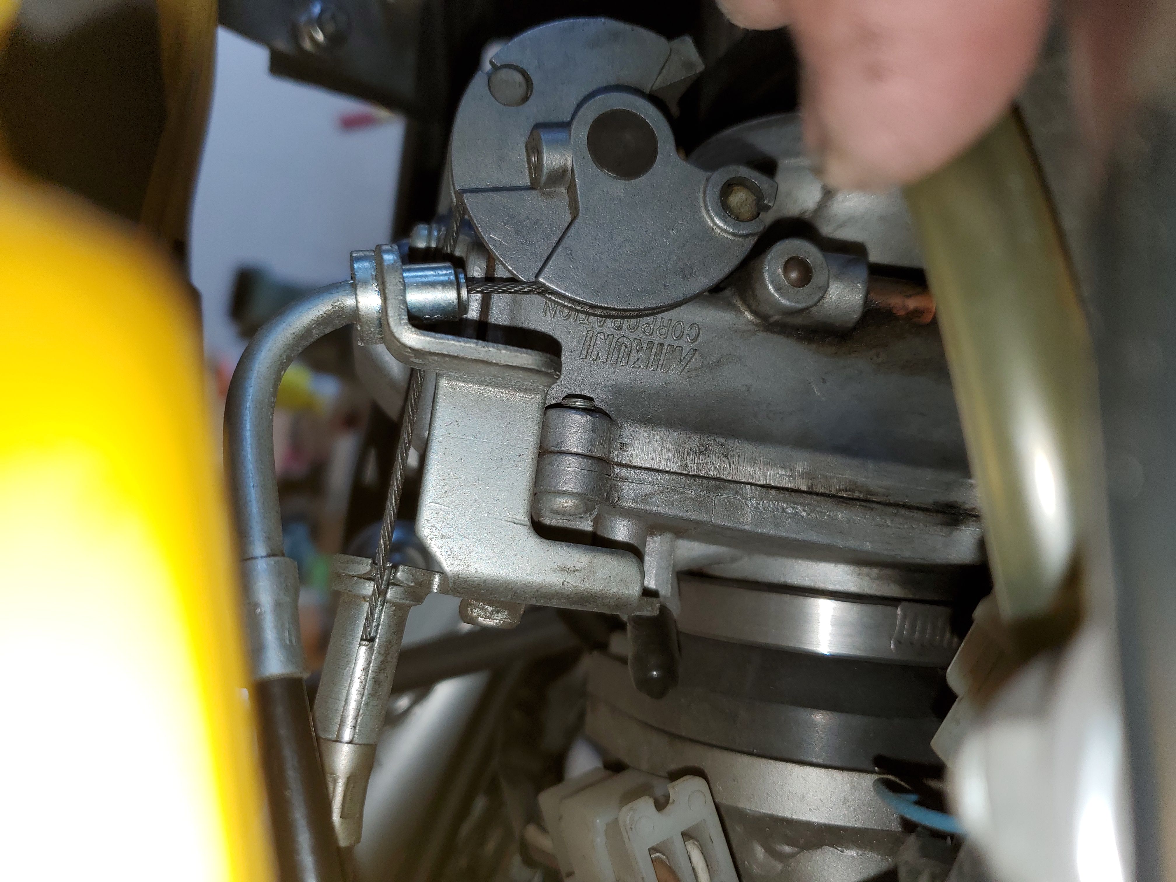

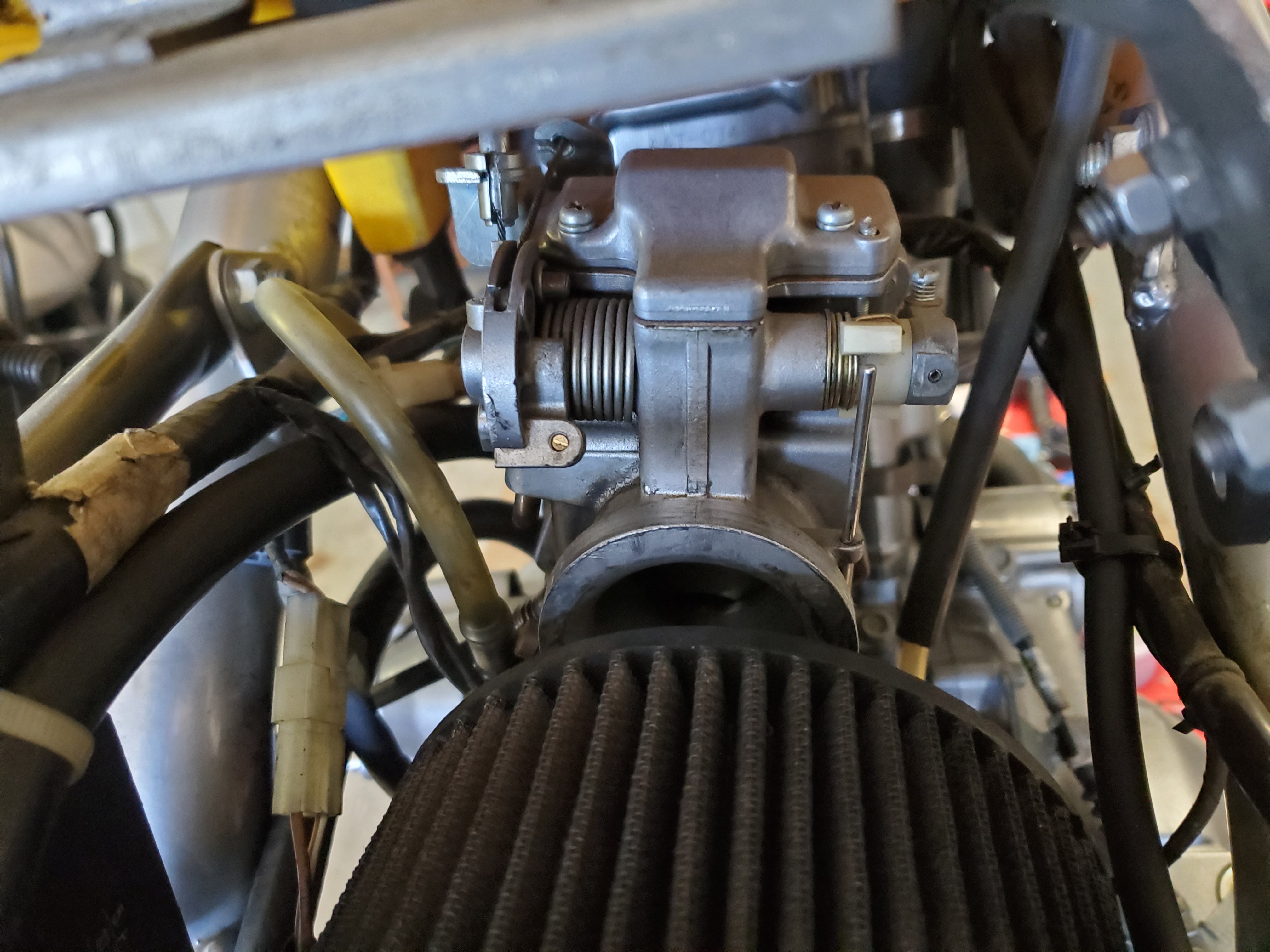

Postby daiku96 » Mon Apr 05, 2021 8:23 am

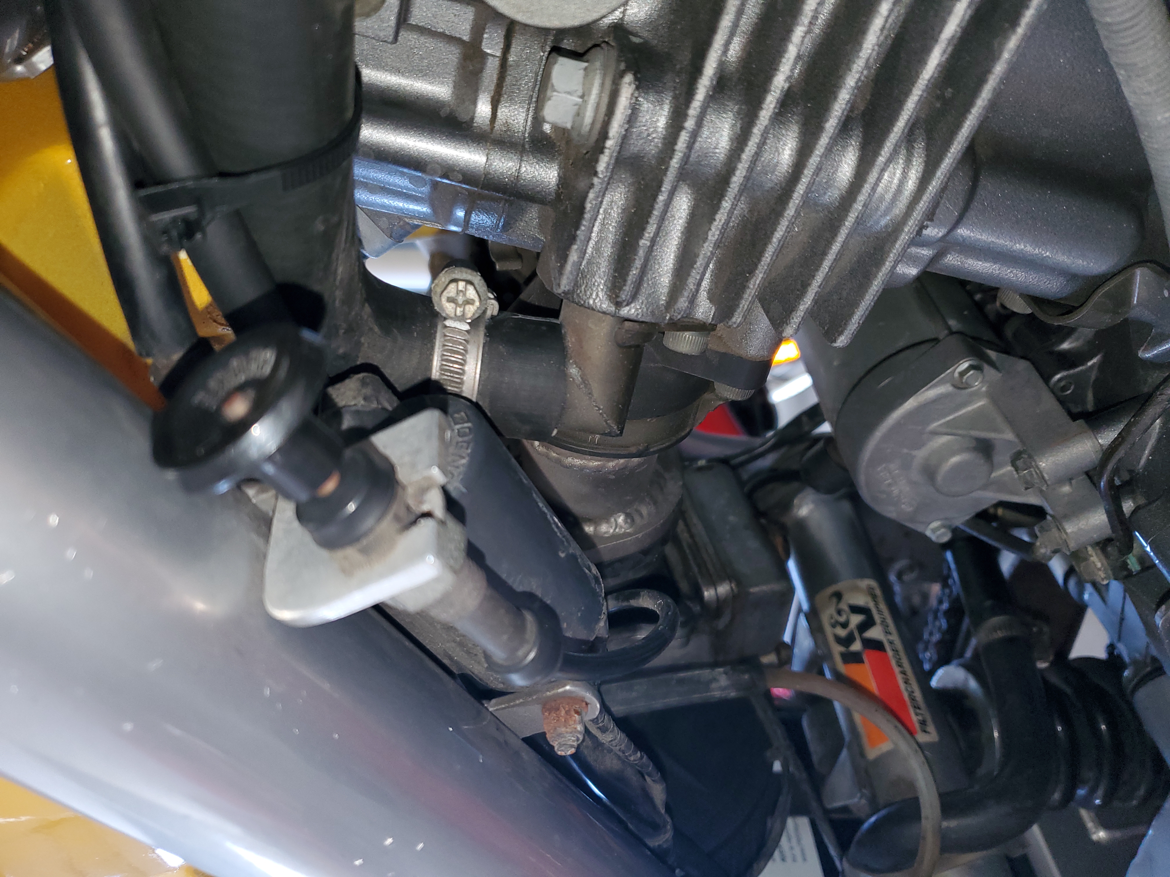

Mikuni pics:
daiku96
Posts: 13
Joined: Thu Nov 12, 2020 3:51 pm
Postby daiku96 » Mon Apr 05, 2021 8:24 am
Separate choke for the Mikuni (handlebar choke is disengaged as it is not longer in use)

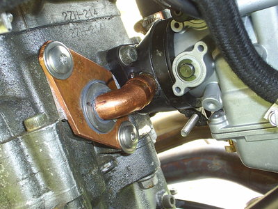

Postby breakwellmz » Mon Apr 05, 2021 9:03 am
Fork seals are generic and readily available you just need to find someone who made a note of the numbers on them when they changed theirs!
Why would you want to change fork springs unless it was for progressive ones?
Here is my cheap `n cheerful single carb setup, don`t laugh it works really well! -
Postby daiku96 » Mon Apr 05, 2021 10:11 am
Nice work there, mate!
Re: fork springs: I thought I'd up the rate for my 210 lbs. You're right, I probably shouldn't bother, it's just that when I get into something I tend to go a bit overboard.
What weight fork oil (if different from what the manual specification is) is preferred for the Skorp?
daiku96
Posts: 13
Postby breakwellmz » Mon Apr 05, 2021 11:09 am
Thanks.
Don`t know about fork oil for yours (I have a Mastiff) but i just Googled MZ Skorpion fork seal numbers and up they came!
I then put those numbers into Ebay and came up with these amongst many others - https://www.ebay.co.uk/sch/i.html?_from ... cat=178039
What is the source of the manifold that joins your single carb to the two inlet ports?
My carb is a pumper CVK 40 intended for a Harley BTW.
