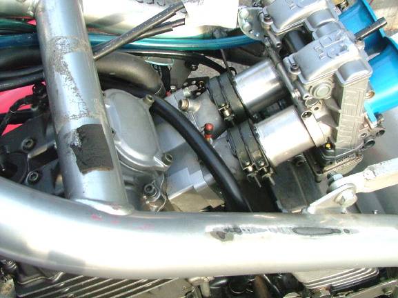

Downdraft intake & headwork by Slipstream Engineering in England. The 762cc motor has 84 RWHP available with short intakes and 8,400 rpm. Pictured are the long intakes & 'small' 39mm carbs, which limit the motor to a mere 78RWHP, but give a flat torque curve (line?) of 60 ft/lbs up to 7,800 rpm for more ridability. Still, it manages to blow by most twins of the same size. Necessitated fabbing a flat bottomed fuel tank to accommodate the intakes.
